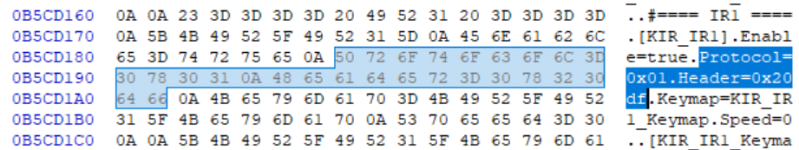

UA34S00 китайський Samsung, шасі TP.SK513S.PB818(T) . Потрібна прошивка usb або для програматора .

Так скидав на заводські налаштування .
Chip Size: User=7456MB,Boot1=Boot2=4096KB,RPMB=512KB.
022: SAMSUNG EMMC Version : V5.1. 10-20% device life time used.
023: Speed set to level 0.
Start reading chip......
026: .EXT_CSDRead successful, file saved.
027: .BOOT1Read successful, file saved.
028: .BOOT2Read successful, file saved.
029: .Authentication Key not yet programmed, the RPMB area is not used, and the data is blank.
030: .RPMBRead successful, file saved.
031: .Start to read the user area data and save, large capacity, please be patient ... ...
032: Buffer data checksum: 16bits_0xFF85 ,32bits_0xBEF3FF85 :
033: The data is read and verified successfully.
034: Elapsed time: 4697 seconds,average speed of 1666411 bytes/sec.
